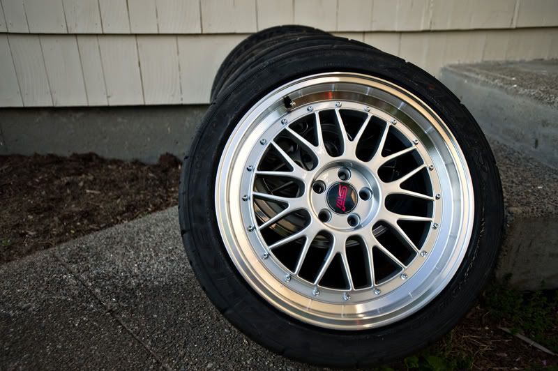

- New 18x8.5 linea corsa lemans wheel set
- blue forged aluminum work lugnuts
- STI center cap stickers (from vendor on Nasioc)
- (4) 245/40/18 Flaken azenis Rt-615's
