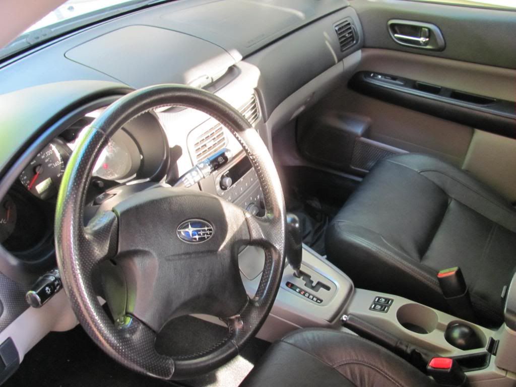

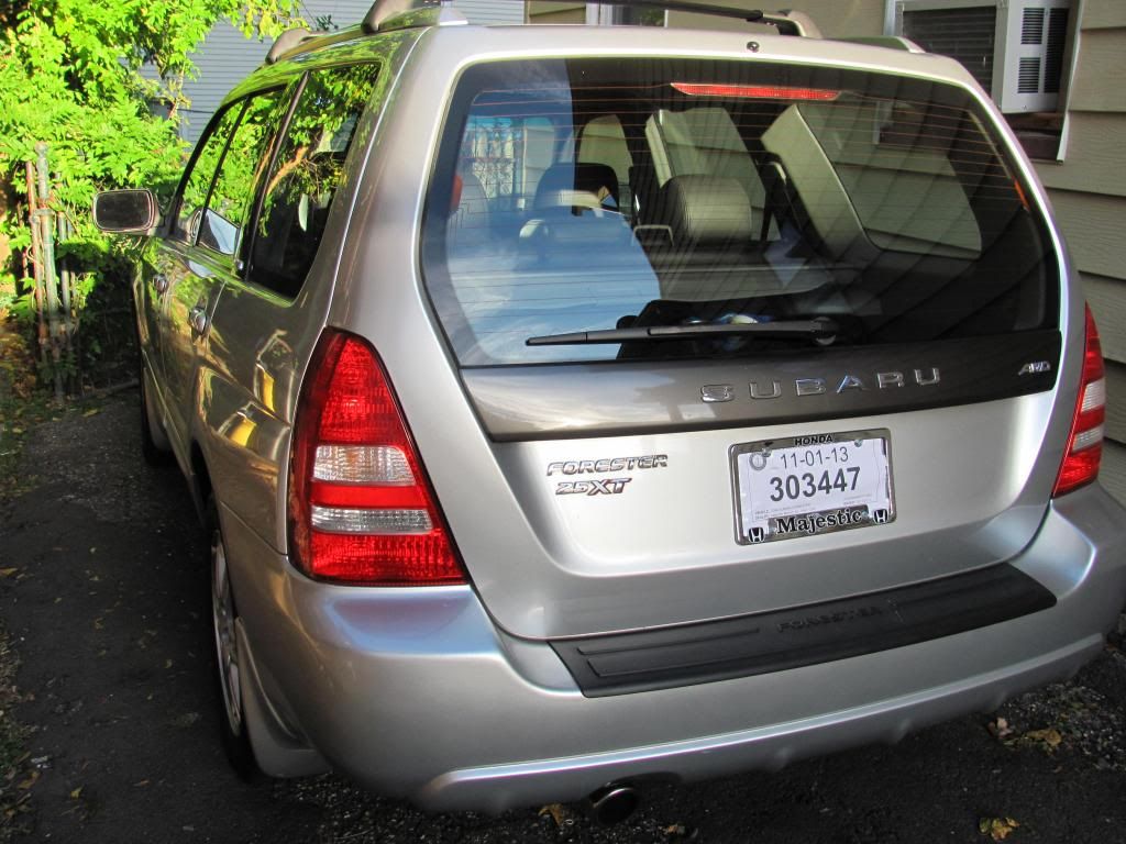

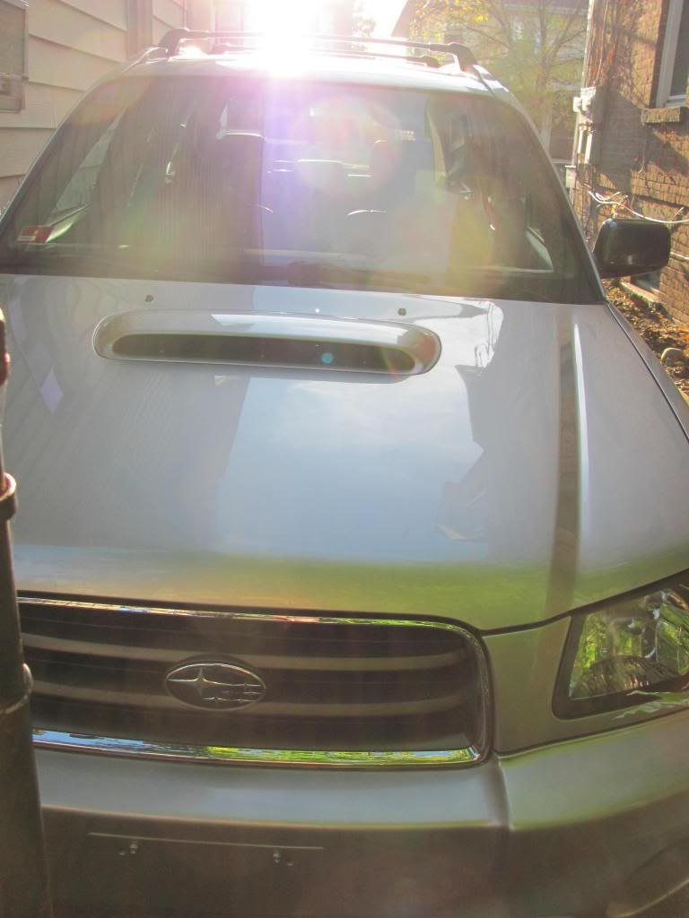

I recently bought this 2004 Forester XT 4eat to replace my 06WRX as a daily driver. Ever since buying it.. all I see is a blank slate. I'm really looking forward to making this car my own.
First thing I'm looking to do is replace the stock uppipe. While I'm doing that hoses, timing belt, water pump, and all fluids will be changed. Rear sway bar and endlinks will be put on shortly as well as some tint. Once the winter passes I'll be looking for swift springs, sti or rotta gravel wheels, and an exhaust system. Eventually I'd like to go for an sti swap.... eventually hahah.
Here's to many more entries :Banane35:
