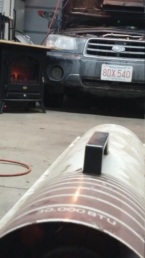

I recently purchased my second subaru, an 05 FXT which was an upgrade from my 00 outback. The new one has about 160,000 on the clock but i got it for a great price and the thing is spotless. Unfortunately it popped a CEL while driving on the highway in the rain about two weeks ago. I live at college about 45 mins from home so i only get a chance to work on her during the weekends. The code registered as either faulty MAF censor, cyl. 1 misfire, or a major vacuum leak according to the autozone reader it was all under one code. First i cleaned the MAF, reset the car and it lasted about 50 miles until i took another highway trip and the CEL popped back on going about 80. My following sunday into monday morning was spent replacing the plugs, oil, and pulling the TMIC off just because I like to learn :rock:. It was about 7 degrees outside and the shop was only about 35 when i started so i had this set up keeping me warm.

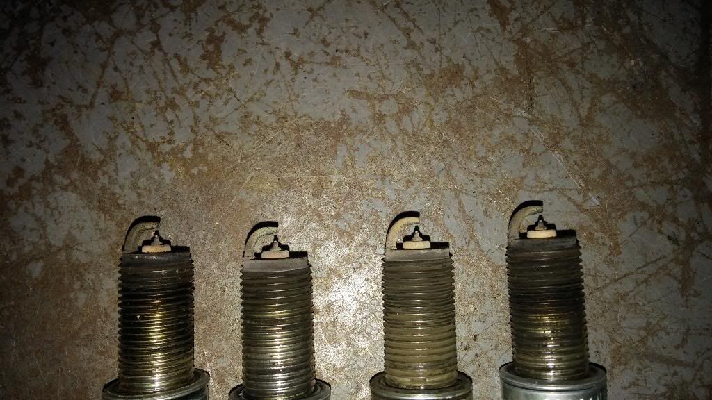

I also planned to do a compression test but the one i borrowed from autozone was no good. The old plugs were gapped at between 0.048 and 0.051 and looked like this.

Quick comments: your old plugs looked good, and you're not pumping oil. You can do a compression test, but it may not tell you anything. Ditto for pulling the plugs again - they will probably look like spark plugs.
