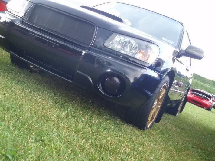

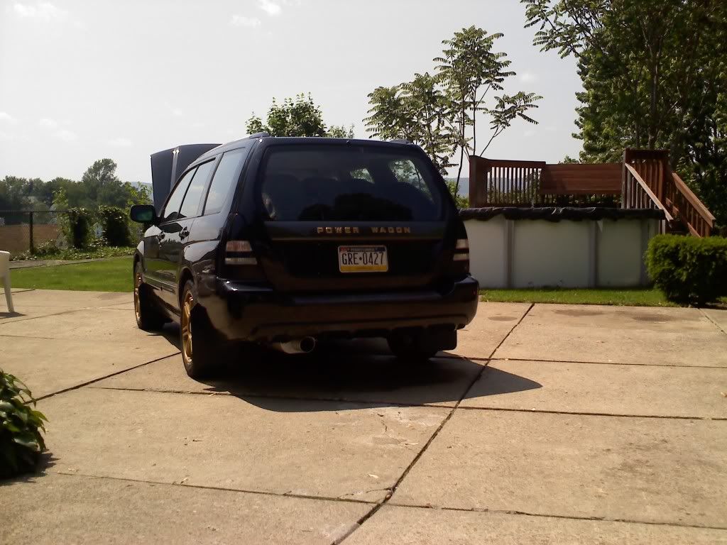

Hey this is a mod journal of my 05 FXT
Exterior Modifications:
Rally Armour Mud Flaps
DIY Grille Mod
VHT Night Shades Tail Lights
Interior Modifications
2009 Subaru Wrx Shift Knob
KartBoy Custom Short Throw Shifter w/Bushing
AEM Digital Boost Gauge
AEM Wideband A/F Gauge
Custom Gauge Pod (Need to Build)
Plasti Dipped Center Concle
Sound System
(Soon to Be)
Custom Ported Subwoofer Box
10" Re Audio SE 600W RMS
Hifonics Amplifier
Suspension/Brakes/Wheels/Drivetrain
2007 Wrx Wagon Springs
R1 Concepts Slotted Rotors
Stoptech Brake Pads
Black Painted Calipers
Enkei 17" Wheels/Power Coated Gold
Hankook RS-2 225/45/17 tires
Stock 16" Wheels with Winterforce Winter Tires
South Bend Stage 2 Clutch
F1 Racing Lightweight Flywheel
Engine/Performance
Borg Warner S200-56SX Twin Scroll Turbo
Modified Ebay header for twin scroll turbo
Perrin Modified 825cc injectors
Walbro 225 Fuel Pump
Custom Resonated Downpipe
Modified Resonated Surewin V2 exhaust
Custom Cold Air Intake
SSAC TMIC
Wyntonm 44mm External Wastegate Rerouted back into the downpipe
TurboSmart BPV
Hallman Pro MBC
Area 1320 Tune
Future Modifications
Wrx Struts & Cobb Springs (Springs Ordered)
XXR 530 17x8.25 or 18x8.75 wheels
Nitto Nt05 tires
Redo the grille mesh
DIY Front Pavers Lip
