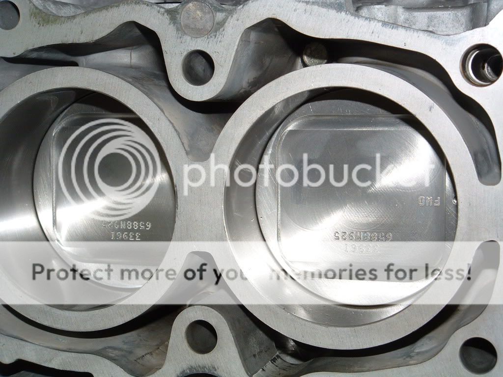

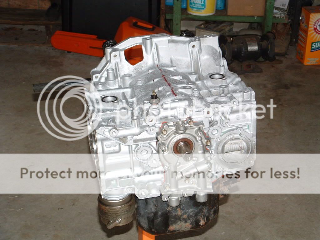

Motor:
2003 2.0 wrx block
2005 2.0 wrx heads with shimless buckets
Wiseco +.20 forged pistons
Acl race bearings
Arp head studs
Subimods 8mm phenolic spacers
Taco made tgv deletes
Gms silicone turbo inlet
Bigger maf + short ram air
Td04 turbo
09 sti oil pump
Sti fuel pump
12.5 lb flywheel
Act clutch

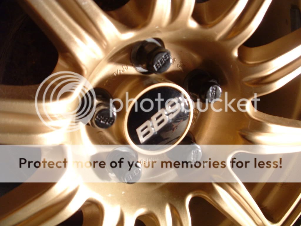

04 sti gold bbs
Black bbs lugg nuts

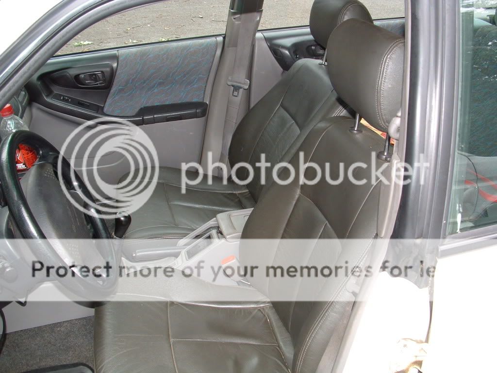

Legacy outback leather seats
