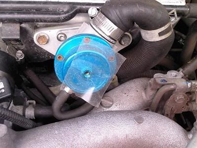

So i'm a little ashamed to admit it but when i put in the new intercooler i put in a cheesy ebay blow off valve cause i'm cheap. Well a few days ago my idle got funky and i through a lean code. i checked it out and found the stud and nut were gone from the previously mentioned cheesy blow off valve. I plugged it up with some tape and it still releases pressure. i'm going to find a new stud and nut for it but i wasn't sure what the stud does. if it is some sort of adjustment or what. any input would be appreciated.

can't put a forester blow off valve on a impreza style intercooler. and don't judge me on the tape i was in a giant parking lot trying to stop a massive vacuum leak i only had so many options

and if it's leaking air / vac through the hole the bolt goes in, then I suspect your diaphragm is damaged. AFAIK it should not leak anything. Like Simon said, it adjusts the spring tension. Without the bolt I guess it's at minimum tension and then it will open at a lower boost. I've never had an after market bypass valve so I'm taking a SWAG though.
Hmm I don't manifold pressure is applied above the diaphragm to suck it open when you lift off.......so if the stud falls out its a leak to manifold.

You are right, I was thinking, pressure leaking not from inside the IC not the vac line to the manifold, my mistake. I wonder if he can unscrew the fitting that screws into the side where the Vac line goes in and see if that fits in the hole where the bolt fell out. Just to see what the thread pitch is. Then take that to the hardware store to match it to a bolt and nut so he can at least get it plugged and working again?
