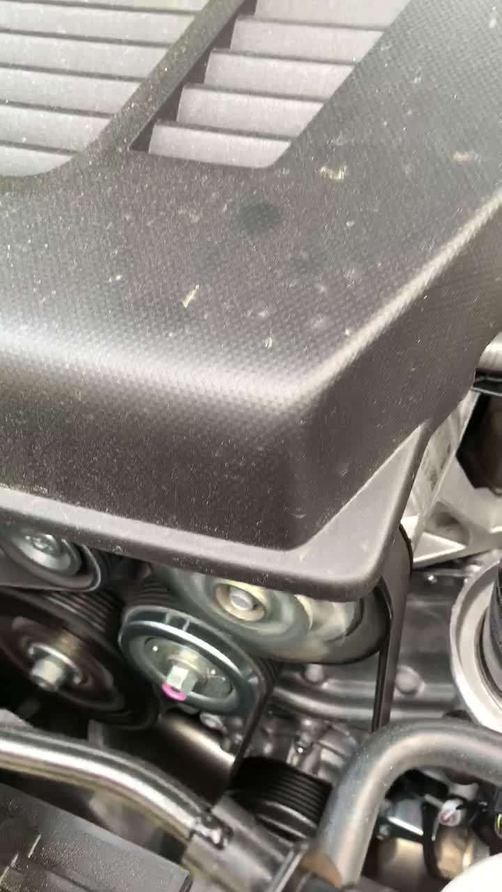

Hey everyone,
2020 Forester premium with about 1800 miles. Hasn’t had its first oil change yet. Noticing an odd grinding or whooshing (??) noise that occurs about every other second or so at idle after the car has been driven for a bit. Please see the link to a video below (you might have to turn the sound up). Figured I would post here before going to the dealer.
Let me know if the link doesn’t work and thank you!
mike

I don't have any answers. But damn does that look new and shiny!
Car has been mostly excellent in the 6 weeks that I've owned it. This issue does not affect the car's drivability either. No power loss, slipping "gears", etc.

Discussion Starter · #9 ·
Update time!
I finally had the chance to bring my Forester to the dealer this morning. Apparently, that noise was triggered by an internal fault within the AC compressor, per my service advisor. They are replacing the compressor under warranty. The part had to be ordered and I should have the Forester back on Friday.
