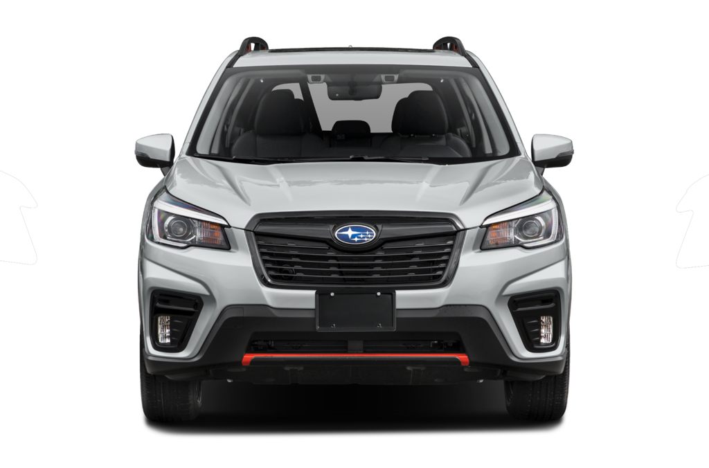

On a funny note, while looking at Foresters online I noticed the same misalignment pop up on marketing images... so this seems to be a curious affliction of this generation! :rolleyes:
carsdirect1
carsdirect2
it got sticker on the hood saying something like "no adjustment needed" but i think its for emission..
