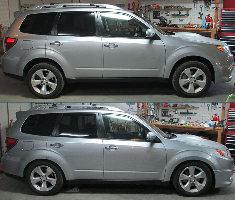

*Impreza/wrx strut/spring complete "takeoff" assembly options. About a 3" drop, with some variation, based on model year chosen.
These are all bolt-in ready. No fabrication or spring removal necessary. These are going to be the easiest to install.
+08-14 impreza (non wrx) model = they'll all work, not sure on rates, but they'll be soft. maybe too soft. i think theyre the same as 08 wrx - 151F/136R.
+08 wrx model = 151F/136R.
+09-14 wrx model = 217F/194R.
***08-10 wrx model struts have a shorter body length then 11-14 model ones, by about 0.5". this will effect things like tire clearance vs the lower spring seat...as well as ride height.***

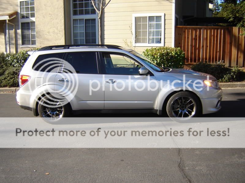

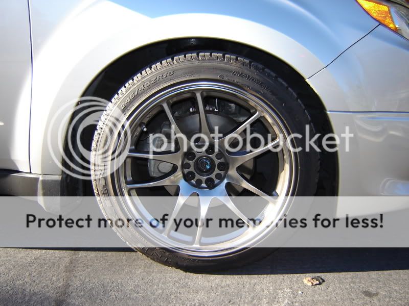

@RAPTR - 08 sti stuff:
With 1" strut spacers , all four corners.
