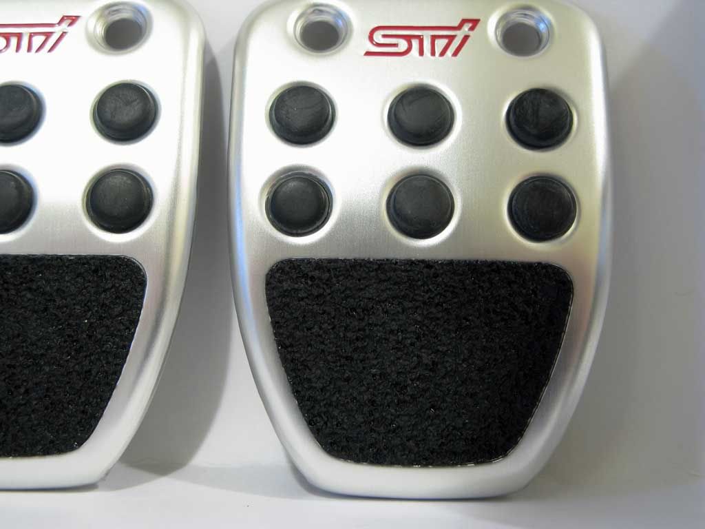

First off, I love these 100x more than the traditional STi pedals with the Pink inserts. While they're still cool these are, well , better. Had the 2010 set not existed I'd have bought the pink ones in a heartbeat. I find the black more subtle, it still looks great but doesn't poke you in the eye yet retains the Pink STi logo.
Now this is what makes them UBER COOL. While they still have the raised black rubber dots for traction, on both the brake & clutch pedal (exactly the same) they have highly textured rubber bases so your feet won't slip. The base rubber on the accelerator pedal is smooth. These are so nice you could mount the set in a picture frame on the wall as art.

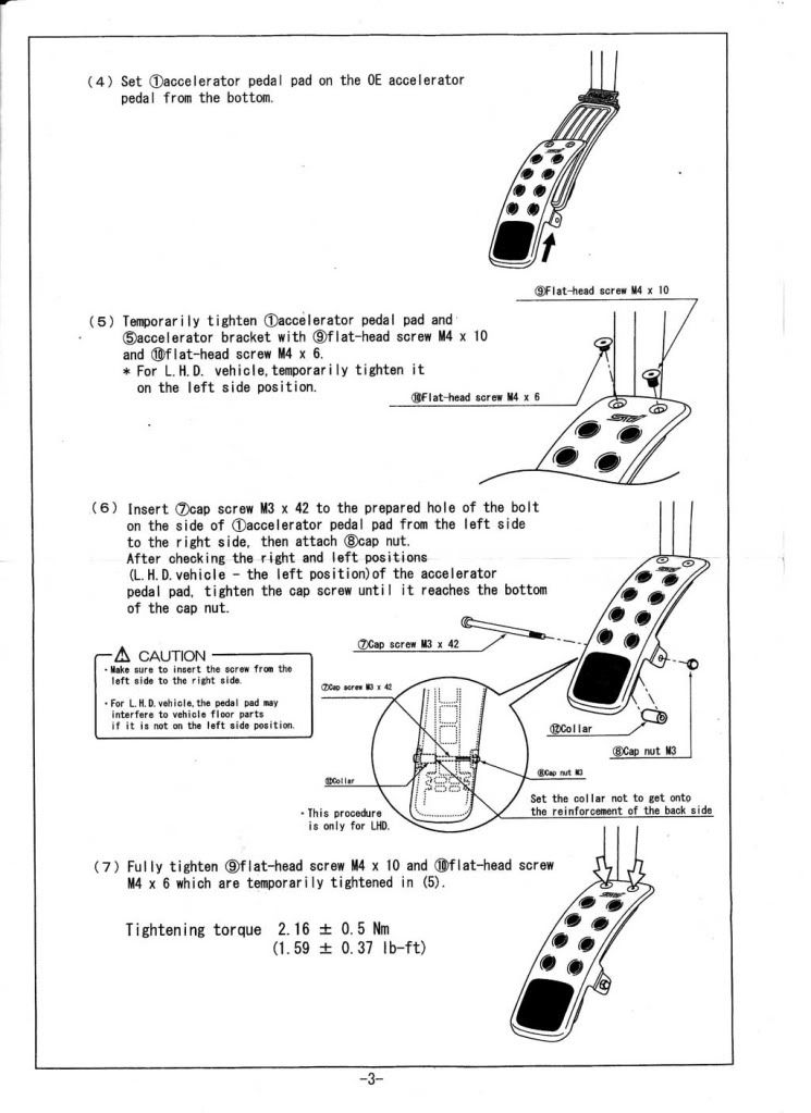

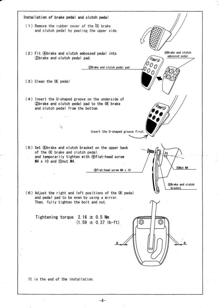

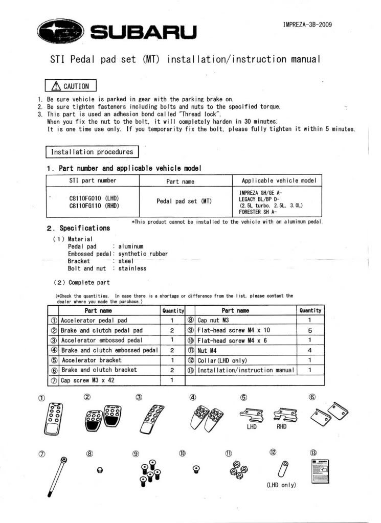

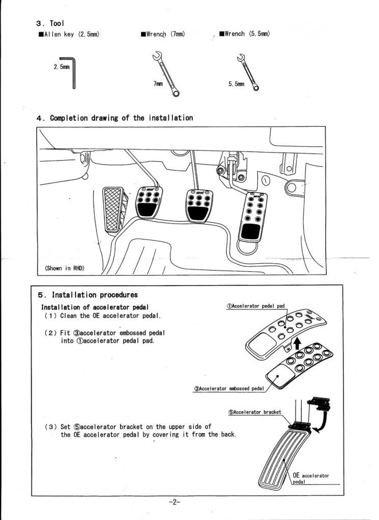

I have the factory install diagrams and will scan those in / post them up in due time.
Instructions: The one part that's missing is on page 3, Instruction #6 it doesn't state to install the collar on the cap screw in text but does show it in the images. If you don't install the collar it doesn't fit up snug on the pedal.
