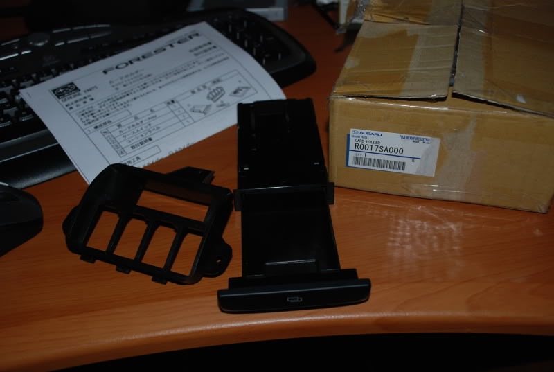

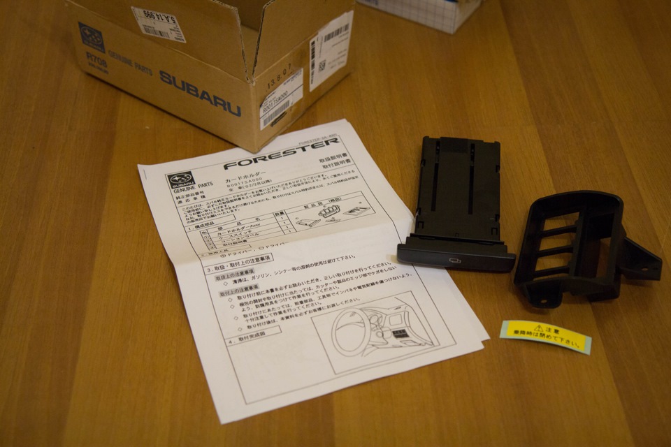

hey guys with the card holder, so i got the "precious" jdm business card holder only and turns out it does not fit my usdm 2006 FXT switch bezel. there is a middle divider that blocks the holder. what have you guys done to make this mod fit? i have no luck finding the jdm bezel that fits the holder. my friend said his 2008 usdm FXT fitted the holder no problem. kinda weird.
ive searched for threads about the holder but theyre all old and pics are gone. what does the back of the actual jdm bezel look like that allows it to attach to the holder? what have u usdm guys done to make it work?
they used to have kits that you can buy, below are some example photos i found on the internet. apparently they come with the holder and the bezel

The OEM switch holder is designed to accept two switches where your blank/blanks fit
The business card holder, as you have found, comes as a kit with a replacement switch holder assembly which has a differently moulded section for the lower part. I would assume "your friend" aquired the complete kit.
Closer inspection of the holder from your photos, you can see the moulding is an oblong tube to accomodate the B/C holder
which you would need to recreate to fit it properly.
Have you asked the vendor of your business card holder if the rest of the kit is still in the vehicle it came from ??

The standard JDM OEM item is the same as the US item albeit for RHD and part number ends in 210 instead of 220.
You require the item that was specifically made for, and supplied in, the card holder kit.
