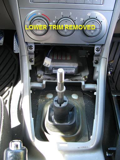

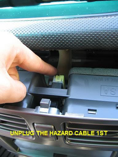

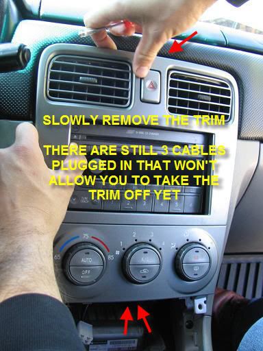

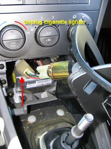

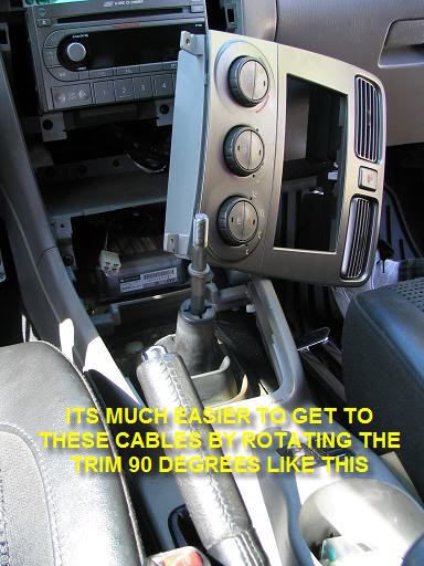

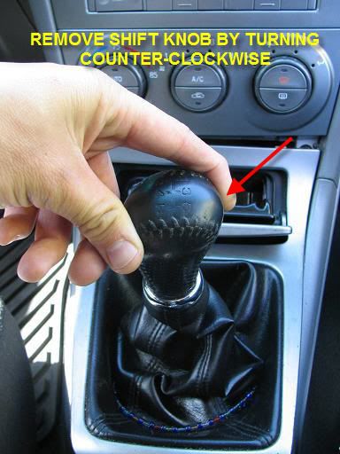

DIY- HVAC Bulb Replacement 2004 Forester

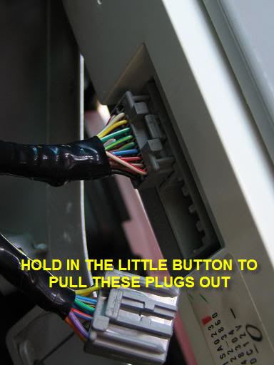

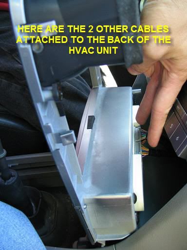

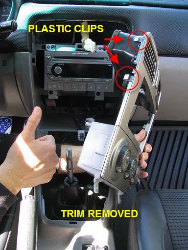

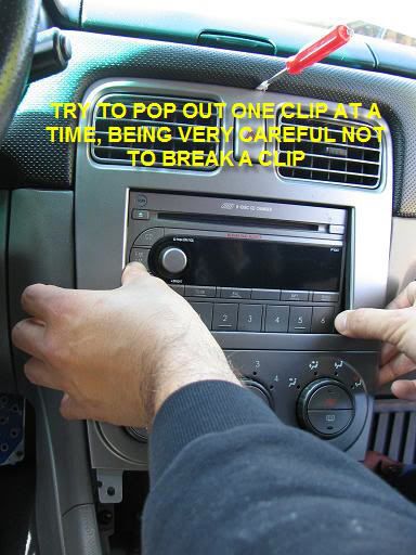

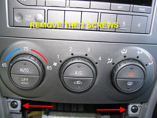

Its happened to all of us.... That little light behind a button, control, or gauge goes out on you.... It doesn't bug you during the day,, but it nags you at night on that drive home.... You fumble in the darkness to find buttons and knobs.... TIME TO FIX IT YOURSELF.....:icon_biggrin:
DARN LIGHT!!
2004 Forester XT-5MT
425 Posts
Discussion Starter #2 (Edited)
continued....
Here's a good bulb change guide I found in one of Peaty's guides...
It doesn't mention anything about the different white bases I encounted with the bulbs behind the HVAC controls....Still helpful though....

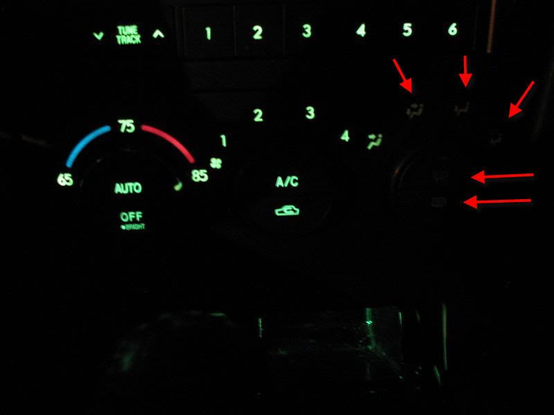

Looks like you could also use these instructions to change the color from green to red or whatever if you wanted to.
I put red LED's in mine, although not bright enough they do work decently. However the position indicators and some other things have their own separate green LED's which would also have to be changed.
