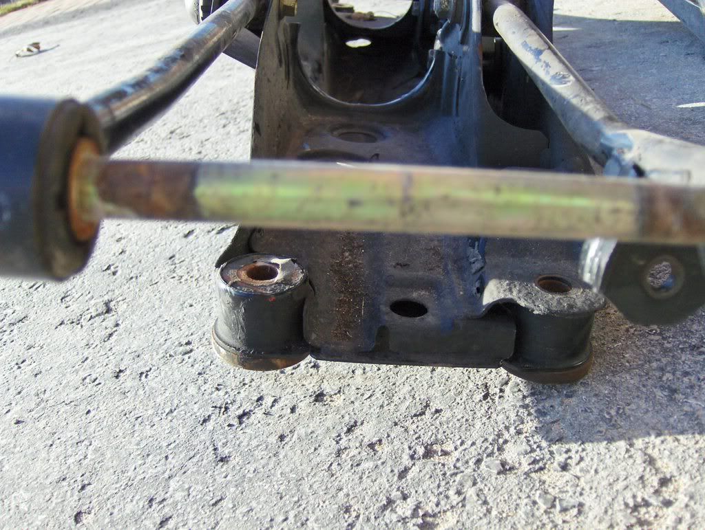

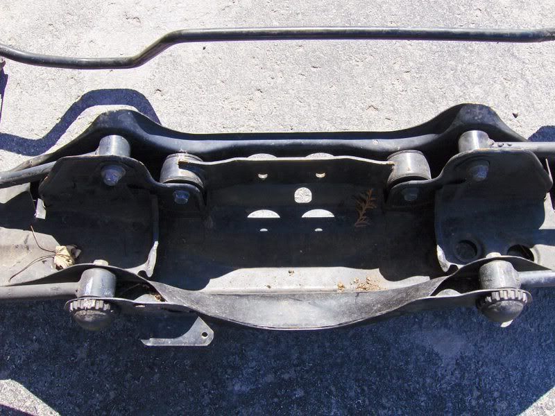

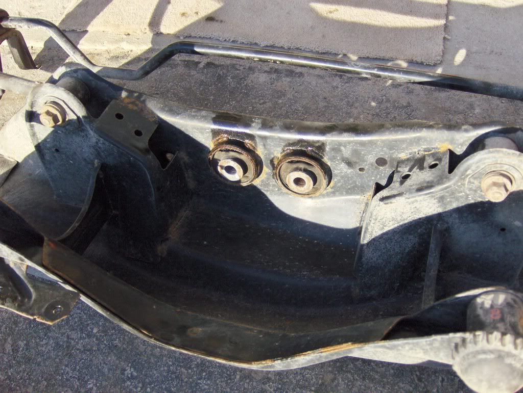

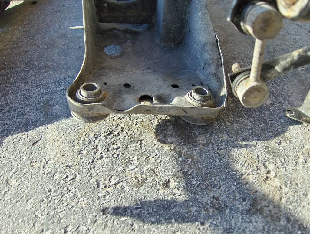

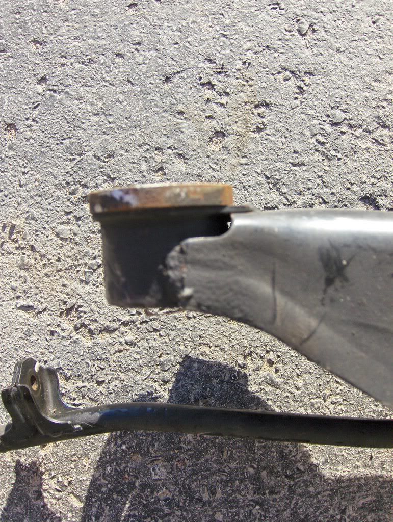

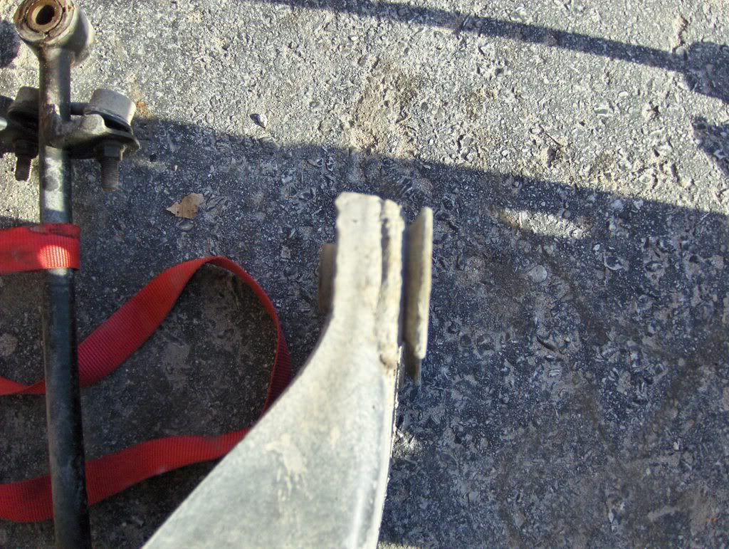

I made a post about this a few years ago but forgot to add the comparable photos.
XT subframe attatchment point.
STi.
XT diff carrier.
ST diff carrier.
The two together. You'll notice that is generally more metal and bracing on the STi version
