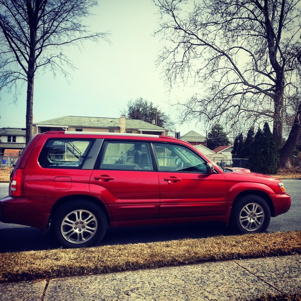

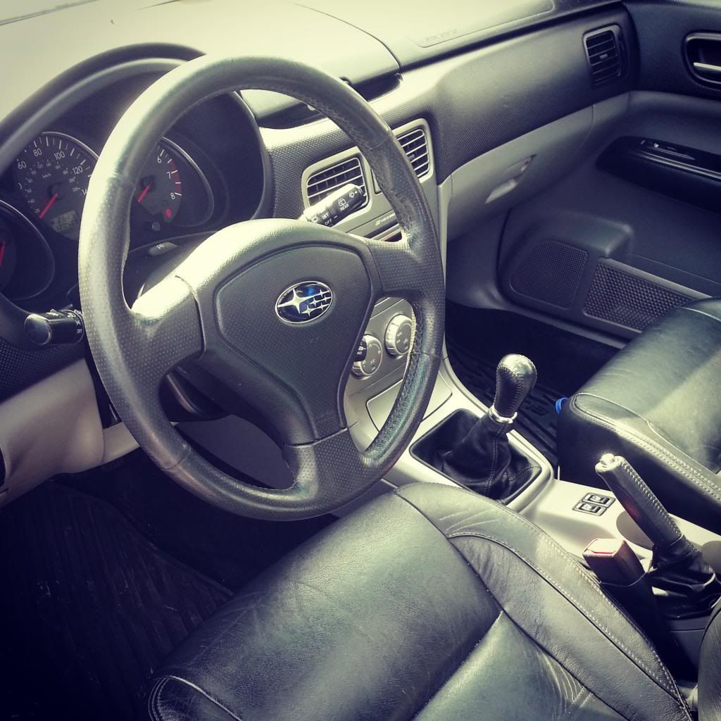

Good morning, everyone. I Just picked up this 05 XT 5MT. I've been looking for one on and off for about two years and finally found one worth my trigger pull.

Nice, lovely colour too. The back box from your WRX will need around 2.5" of an extension to clear the bumper and the hangers will need to be lengthened as well or new longer rubber mounts bought. Cutting the exit pipe from the silencer can and adding the extra pipe at that point is probably the easiest place to do it. Failure to do this will melt the plastic bumper, as I did initially, and also increase the likelyhood of CO fumes entering the cabin. All other pipes from the WRX exhaust after the turbo should bolt straight up but be aware of the rear O2 sensor mount.
