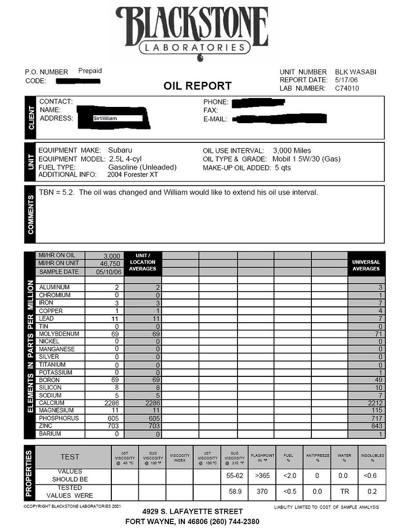

Here is my Blackstone Laboratories report of oil in engine w/ 46,733 miles on the car:

Too small :(

Heheh...fixed

Your lead looks a little high. Blackstone didn't comment on that? Are you using a fuel injector cleaner or are you racing (on a track :-D )?

My lead values were high but there are also two other varients that could have lead up to this:
1) I think I didn't wait long enough when draining my oil to grab the middle bit of oil for a sample(if you have done this analysis, you know what I am talking about)...I think I may have gotten too much of the first/early oil.
2) I am not quite sure the name of the valve but there is a hose leading to it from the engine that kept getting loose on me which I finally ziptied down to keep it in place. My friend who is a suby mechanic said that boost could be escaping there and the engine would think that it is at a certain boost (when it wasn't) and add more fuel...but I don't really think being too rich would cause lead levels to be high. Here is a pic of the valve:

See what Terry says. I wonder if an Auto-RX rinse will get the lead out to make the next uoa more accurate (the lead might still be there even if the problem is resolved)?
You might want to post the uoa over at bitog for the experts' comments. :-)

Well, I gathered from the info I got back stating that I had a "too restrictive air filter causing too much fuel in the oil" that my K&N was dirty. I took a look today and dirty was an understatement. Guess I will be cleaning it every 20K miles instead of 40K miles.
