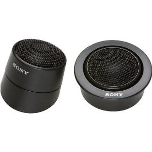

So, I recently got a Christmas gift from my wife... a Sony XAV64bt...
Other than that, everything is stock. I ordered sony's XSH20S tweeters
For my next steps, I will most likely be changing the stock speakers and installing a subwoofer in the trunk. Any recommendations?

My recc.... Ditch the Sony tweeters, buy a proper "component" set... The Polks mentioned above are an option...
Subaru's require a spacer to get anything "decent' in the car, in terms of speakers...
This is part of the reason "slim" models are made (Polk 651s)
First off, ditch the tweeters.... there's a lot more to car audio than haphazardly adding speakers..

What you probably want is a 2-way component system with a separate woofer and tweeter. Like so, in fact these are the Polk Audio db6501, which is a 2-way component system:
The stock tweeter is placed in the sail panel at the bottom of the A-pillar in your Forester, and the woofer is in the bottom of the door of course. In your system with an added subwoofer and highpass crossover (does your HU have this function?), the woofers in the doors would probably handle <125hz and the tweeters might reach all the way up to 20kHz, which is nearing the high frequency limit of human hearing. 20hz is about the low frequency limit of human hearing.
