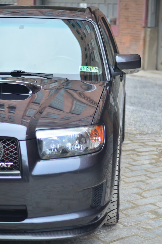

Pic showing what the offset looks like compared to the fenders:

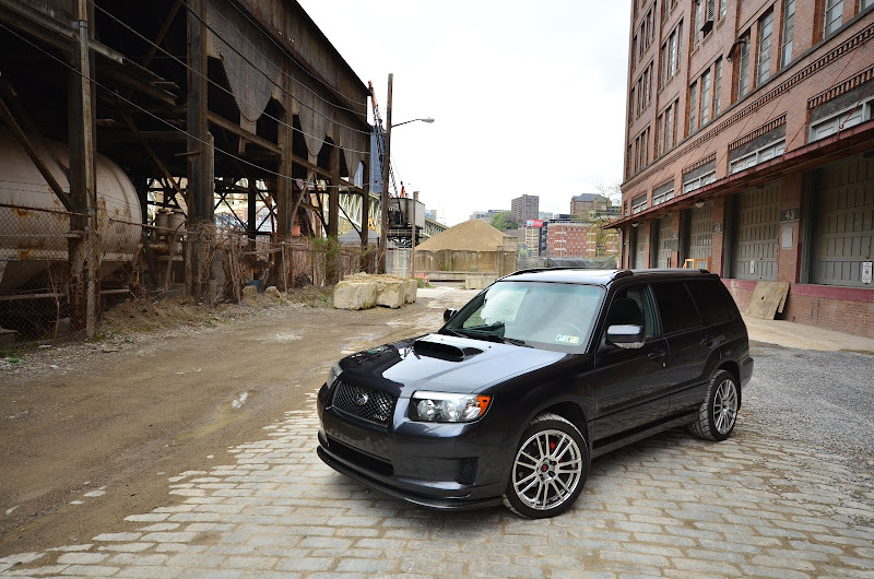

Here are some pics of the wheels on the car:

A-Mazing!
I really think this looks good.
And has me thinking about converting spacers.
Can't shaving out parts of the wheel throw off balance?
soundsofsnow is offline   Reply With Quote

Yes, technically but not really an issue. I did it very evenly, but also the closer the weight is to the center of the wheel the less it effects the balance. They put the weights all the way out towards the edge to maximize their effectiveness. Even if I did change the balance ever so slightly it is probably under the minimum weight increments due to how close to the center it is.
If I did feel there was a balance issue it would also be really easy to fix with one trip to a tire shop.
