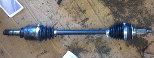

Passenger Drive Shaft (CV) Boot Replacement
This job was supposedly projected as an all day job... after doing it, I can see why. Though, I must admit, playing with grease is fun. It took some time to get the drive shaft free, but was fairly straightforward with the rest. Took the one end apart, cleaned out the other (after smacking it with a hammer and feeling like idiots once we realized it couldn't be disassembled like the other end), applied fresh grease and installed boots acquired from Jackie, and done.
(Continued below)

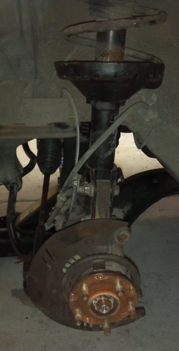

SG Suspension Upgrade
When I got the struts in, they were covered in rust bubbles and nastiness that didnt hint at them having only 50k miles on them. Regardless, I set out to cleaning them off before spraying them down with some leftover plastidip.
(Ill add before photos later)
All scraped off and sprayed over

Default Bad luck... with brakes! Perfect.
Earlier today I was on my way to my folks house in a neary city to visit for Easter, when upon entering it, I found my brakes were more squishy then normal... then completely gone! As I was coming up to the stop light, I had to resort to the E-brake to bring myself to a semi screeching halt.
I couldnt figure heads or tails out of it! I knew my brake pads and rotors needed replacement and the system needed a flush, but it wasn't that bad! I figured I just needed to get to the where my folks were and see if we could all figure it out, so I proceeded cautiously and slowly with my hazards on.
After taking a look at it, I found a nik cut out of the driver side brake hose that was spewing fluid viciously every time the brake was pressed. Then I remembered:
While installing the new suspension, the mounts for the brake lines had to be cut off with a Dremel to allow us to swap it out. During the process, the hose was cut and shaved in various points, leaving one major gouge and plenty of scuffing. We observed that the line would hold for the time being and continued work.
So with that knowledge, I decided to go to autozone, get some rubber hose and some worm gear ties and try patching it (as they didnt have any hoses available in any stores in town). However! The patch didnt work and only seized the caliper in the closed position and didnt allow any movement of fluid at all. I decided "he** with it" and just drove back on low cruise and didnt use brakes, thanks to low gears. While I was driving, I realized there were several other options that could have been tried, but didn't bother to pull over and waste day light that was quickly leaving.
