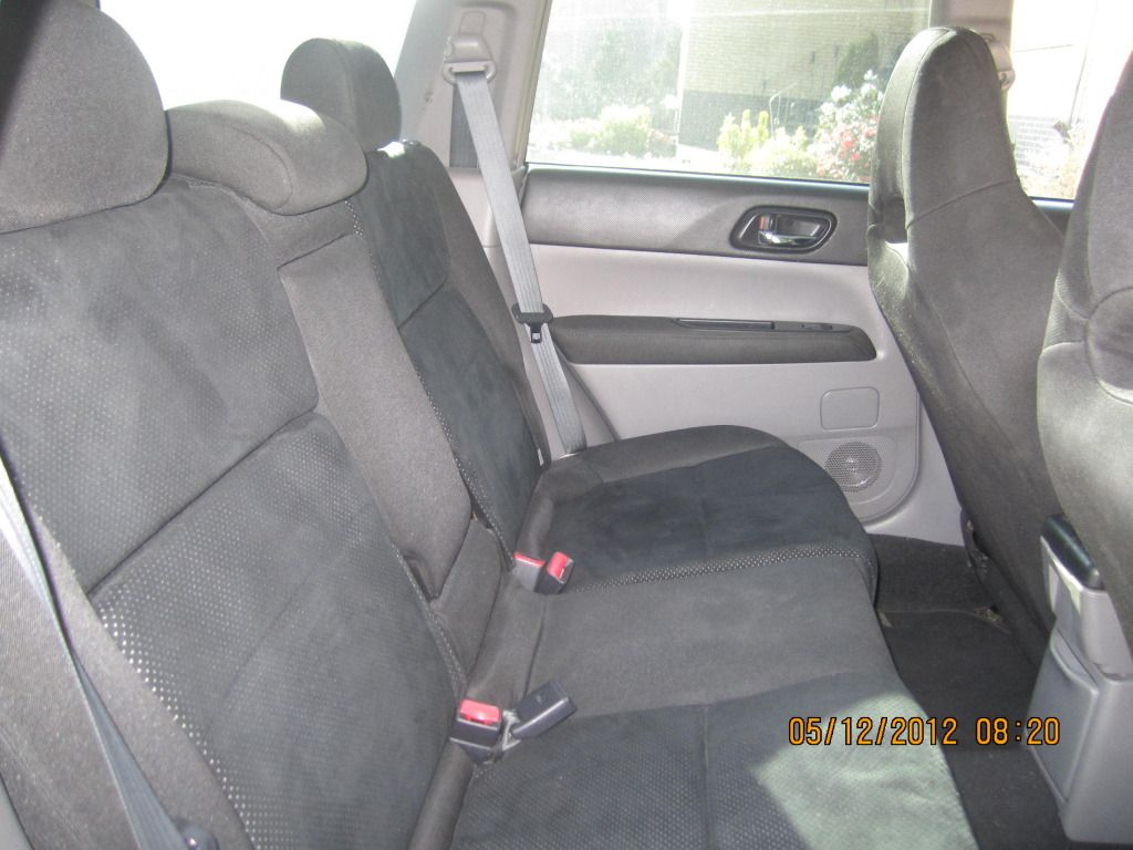

Also got a set of Forester Alcantara STi Seats front & rear and all door cards, the rear is the only issue that I'm gonna have problems with, the sliders do not have no place to bolt up, gonna have to take some measurement and see if I can make them work.
