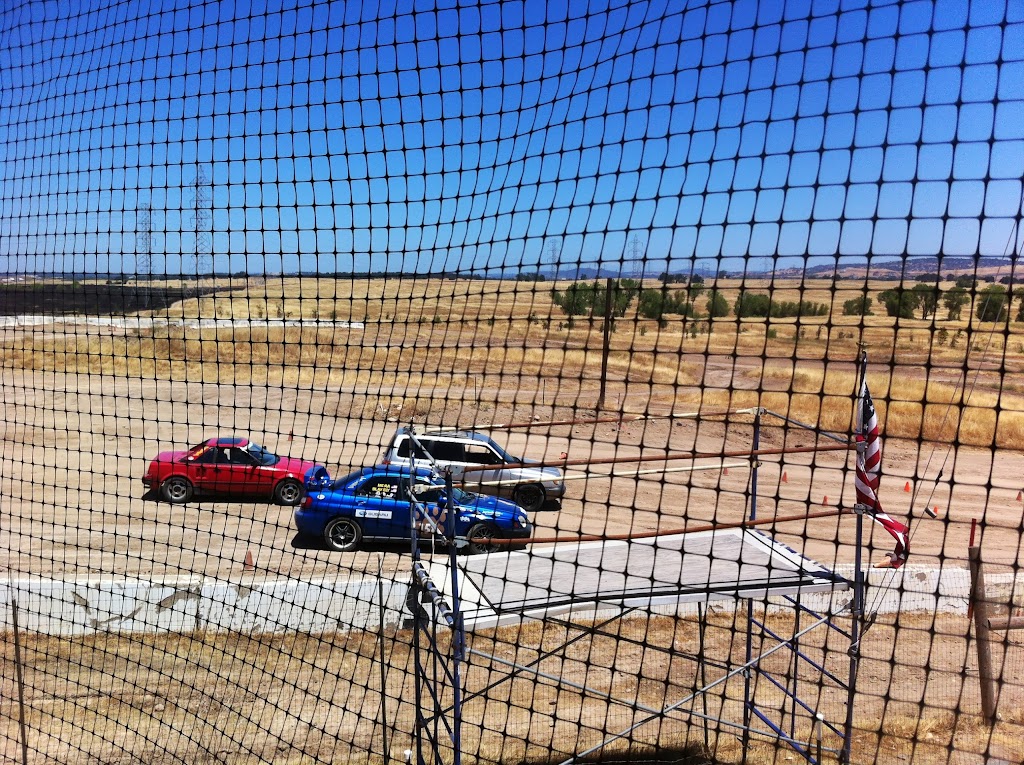

In the time between I did attend the local Prairie City RallyCross, not pictured is my friends red 89 FC GTUS
Definitely broke in my new clutch launching off the start.
Times were okay and got better throughout the day
65.4
68 - hairpins suck! under steering into a pile of dirt in a hairpin really sucks
64
62
59.75 - Balls to the wall run,
62.08 - ****ing cones and gates!
For the Foz I was pretty proud of myself especially given how shot the suspension was going into it, My buddys RX7 averaged 65 throughout the race so I'm pretty ****ing proud of myself.
Hoping to have my rear sway done before the next RallyX at Thunderhill in August.
